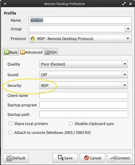

Make sure port 3389 is opened on your firewall and router.
In Remmina edit your connection, click the "Advanced" tab and choose RDP under the "Security" option and save.

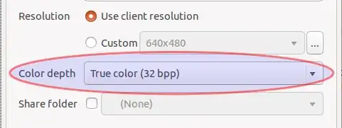

None of these solutions were actually right for me. But on my machine, the Color Depth setting MUST be set to "True color (32 bpp)" to work. This may be different depending on your Windows settings, but it appears that any other setting will just fail with "Unable to connect" message.
All other settings are default, created by the new connection in Remmina.

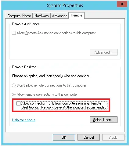

When deleting the host from ~/.freerdp/known_hosts doesn't work, try checking the windows remote desktop settings.
For me disabling "Allow connections only from computers running Remote Desktop with Network Level Authentication (recommended)" did the trick. (search for "allow remote access to your computer" in control panel.
