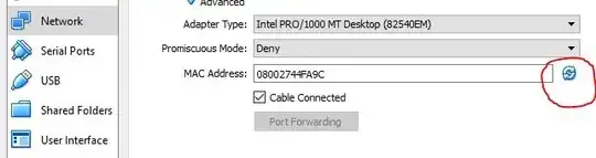

Shutdown your Virtual Machine and then!!! Go to network settings and click on refresh MAC address button a few times :)
and start your VM and you should get internet!

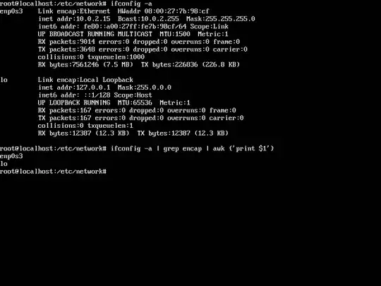

Run this simple commands to see if your network interface(s) are set to come up when the machine boots / restarts.
grep "auto" /etc/network/interfaces
If no lines are printed to standard output, then open /etc/network/interfaces with a text editor (vi, nano, sed) and hopefully you will see something similar to the image below below.
A default /etc/network/interfaces file
Obviously, if grep did not return any lines to the terminal window, the format of your /etc/network/interfaces cannot be very similar at all. :-) However, follow the format of the auto lines.
auto lo
(Loopback configuration follows)
auto enp0s3
(primary interface configuration follows)
Now, on your machine.
auto yourInteraceNameHere
(your interface configuration follows)
Don't know which interface names are available? Run this command.
ifconfig -a
The following command will return just the names of the network interfaces.
ifconfig -a | grep encap | awk {'print $1'}
