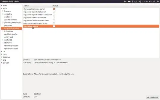

you may use dconf editor, look after apps menu, and see indicator session
1st you may not see the battery indicator and your username/account session, then go back to dconf editor, check back the one you un-check just now, then log-out and log-in back.
