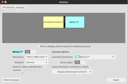

All windows opens on left monitor and all new files gets saved there, I want my right monitor as my primary monitor so all this happens there.
As the picture below shows I have set the launcher on my right monitor but that doesn't help with my problem.
Display settings
