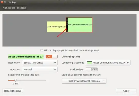

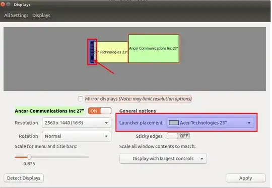

For what it's worth at this point, you can adjust which monitor is the primary by dragging the menu bar from one monitor to the other.
  • Go to System Settings > Displays
  • Hover over the menu bar on your secondary monitor
    • Click and drag it over to your preferred primary
  • You can also adjust the Launcher Placement dropdown to reflect which monitor you want it on, or on all monitors if you prefer.
  • Click Apply
Before Adjustment After Adjustment

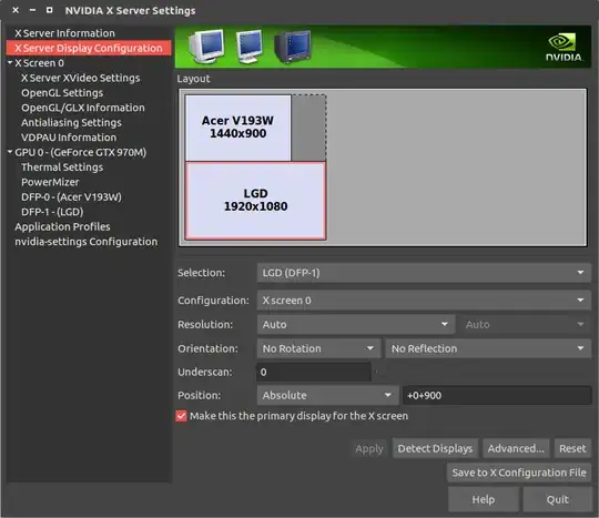

If you are running an Nvidia card (with Nvidia drivers), you can use their settings tools to set the primary monitor. The Nvidia drivers have more options than the native Ubuntu monitor configuration.
  1. Run the following command to start the Nvidia Settings Configuration
    sudo nvidia-settings
    If this command isn't found, this solution will not work until you install the Nvidia drivers.
  2. Select the "X Server Display Configuration" tab on the left.
  3. Select the monitor you want to be primary (in my example, I want the LGD display to be primary).
  4. Check the "Make this the primary display for the X screen" checkbox, then hit "Apply".
  5. Quit the settings window, then run this to make this change persistent through reboots:
    sudo nvidia-xconfig
I had this issue before, and I had some wacky monitor setups. This has always worked for me (on 16.04 right now), hope it will work for anyone else out there with Nvidia!

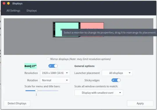

If I'm not mistaken if you do the following
  • Click on the Power button enter image description here
  • Go into the Display menu
  • Rearrange your two monitors in the way you like by dragging the highlighted screens as below (there will be 2 in your case):
  • And then making sure the launcher placement is on your primary screen, then should do the trick I'd assume.

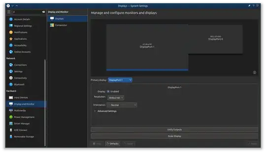

Kubuntu 18.04
  1. Open System Settings.
  2. Go to Display and Monitor > Displays.
  3. Click the dropdown next to Primary display.
  4. Select the desired display.
  5. Click Apply to save.
Kubuntu set primary display
