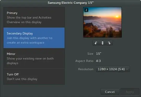

Ubuntu GNOME 14.10 features GNOME 3.12. Open Displays, and choose the secondary display. A list on the left lets you set the display to "Primary", "Secondary Display" (selected), "Mirror", or "Turn Off".

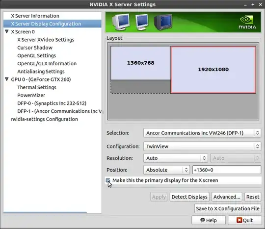

For NVidia video cards:
Run the NVidia settings tool. On a default desktop install with the NVidia proprietary drivers enabled, this is: System - Administration - NVIDIA X Server Settings
Select "X Server Display Configuration".
Choose the display you want to be the primary display and check "Make this the primary display for the X screen" and hit "Apply".

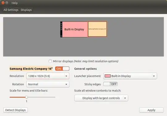

In Ubuntu this can be solved as follows:
Click on the Gear Icon on the Unity launcher (the bar on the left side of the screen). The icon is labeled System Settings
Look under the Hardware Section and click the Displays icon
Turn off Mirror Displays (optional)
CLick on one of the display rectangles and drag the displays around to whatever order you prefer
Set any other desired options. For example, you can set the Launcher to only show up on one display
Click Apply
You will now have the primary monitor setup as desired - all without using the command line as mentioned in your question.
