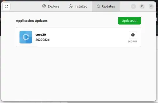

What I did it was: In terminal (ubuntu 22.10)
~$ snap-store
You get
And that is all.
Edit: In my new machine, I get a windows and I must go to the button "Manage..." for updates snaps

An alternative way that worked for me was to go to the search bar and search for snap store, open that up, go to the update tab, then press update.
