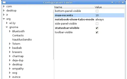

I tried the dconf-editor (see first answer on this page) on 32-bit Ubuntu 12.04 LTS and it worked without a hitch. The steps include:
  1. In terminal: sudo apt-get install dconf-tools
  2. In dash, find and launch dconf Editor
  3. In dconf Editor left pane, expand org -> gnome -> gedit -> preferences
  4. In dconf Editor left pane, select ui
  5. In dconf Editor right pane, double-click the value next to 'max-recents'
  6. Type new value (I entered 20).
  7. Press Enter
  8. Close Configuration Editor.
