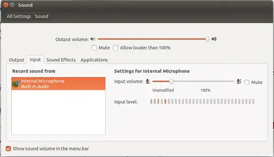

I want to add my internal audio as a recording device so I can record my mic and the computer audio (while wearing headphones) in Audacity.
I'm opening up the sound settings in Ubuntu to get to the following page
How can I add my internal audio to the list here?

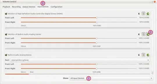

Most modern sound adapters have output monitoring channels. Unity/Gnome default sound settings tool (part of unity-/gnome-control-center) does not list them on input tab.
  1. Install PulseAudio volume control tool (part of upstream project)
    sudo apt-get install pavucontrol
  2. Run it and go to Input Devices tab.
  3. Look down to the right corner, Show: drop list, set it to All Input Devices (Default: All Except Monitors)
  4. As it shows up, you can set it as default.
    picture: pulseaudio volume control - show the monitor lines
If you can't find it, then either it is not supported by driver or hardware itself. You may need to create a virtual loopback.
