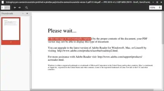

When I try to open the PDF file I need it looks this way (I have tried Evince, Chrome and Firefox), saying
Please wait...
If this message is not eventually replaced by the proper contents of the document, your PDF viewer may not be able to display this type of document.
You can upgrade to the latest version of Adobe Reader for Windows®, Mac, or Linux® by visiting http://www.adobe.com/products/acrobat/readstep2.html.
For more assistance with Adobe Reader visit http://www.adobe.com/support/products/acrreader.html.
