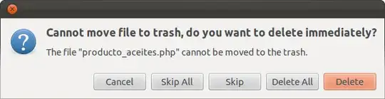

I am trying to delete files in Nautilus and every time I try to delete one it always gives me this message:
Cannot move file to trash, do you want to delete immediately?
Then it gives me several questions. All I want is that when I press Delete in the keyboard, it sends it automatically to the trash can. Not to ask me every time.
The problem relates to NTFS partitions, external drives but also include Linux filesystems.
What are the reasons for nautilus beeing not able to move to trash?

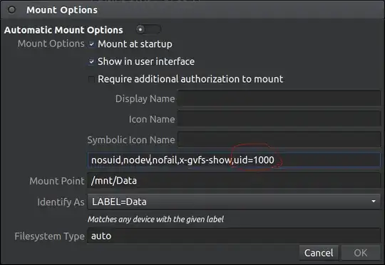

On 16.04, I ran into the same problem. The solution was opening Disks, clicking on the NTFS partition -> on the little gears icon underneath (Additional partition options)-> "Edit Mount Options" and adding "uid=1000" (no quotes, separated with a comma) to the line above the Mount Point (see picture).Modifying fstab mount options through the Disk utility
uid should be set to an alternative number from 1000 as returned by the "id" command from the terminal if you are not the original user, as mentioned here.
