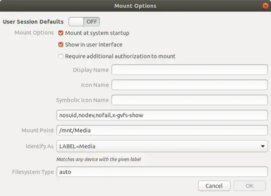

According to this answer, it can be solved by adding uid=1000.
To know your account's UID, open the file /etc/passwd and search the last few lines of the file for your username. In my system there were two users, so there were two lines specifying uid's for the first user and the second user. The second user's uid was 1001.
Add the uid's to the mount options you see in Disks / Gnome Disk Utility. Specifically, you would change your mount options to nosuid,nodev,nofail,x-gvfs-show,uid=1000.
Note: By doing this, you'd be giving folder permissions for only your account. The other user won't be able to move files to trash because their uid is not mentioned in the mount options. A better workaround is needed.
