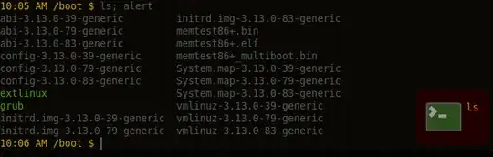

And here is an example of the default notification on my system (using xfce4-notify) when I run ls; alert which, of course, completes successfully:
01Default-alert

I can modify the existing alias to include a line of text above the command like this:
alias alert='notify-send --urgency=low -i "$([ $? = 0 ] && echo terminal || echo error)" "Task finished" "$(history|tail -n1|sed -e '\''s/^\s*[0-9]\+\s*//;s/[;&|]\s*alert$//'\'')"'
Then, if I run ls; alert and asdfgh; alert I get the notifications shown below.
Task finished successfully
Something went wrong
My question is this: Both notifications show "Task finished" but can the same logic that is used to decide whether the terminal icon or the error icon is shown be applied again to determine which text string is shown above the command? So, if the terminal icon displays, the text would be "Task finished" but if the error icon displays, the text could something like "Something went wrong!"
