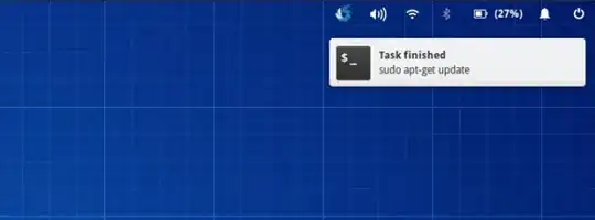

elementaryOS has the following feature to notify the user of a finished terminal process.
Is it possible to use this feature in Ubuntu?
Figure 1: Example of eOS terminal notification

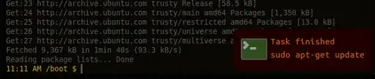

Here's what I see:
OSD alert

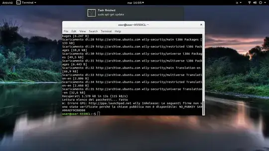

You can set $PROMPT_COMMAND to trigger a notify-send command upon a command's completion in ~/.bashrc:
PROMPT_COMMAND='notify-send --icon=/usr/share/icons/Adwaita/256x256/apps/utilities-terminal.png "Task finished" "$(history | sed -n "\$s/^  [0-9]\+  //p")"'
The caveat is this can become pretty annoying soon, because it will send a notification each time a command is run.
