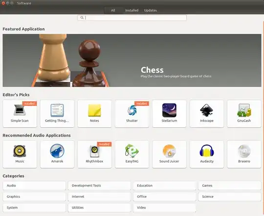

  • repositories show non-free and free applications. I am afraid in 16.04 this is still the case and I doubt Canonical is ever going to give in on this. Commercial applications have a place in Ubuntu. The 1st page that shows does not even tell you that there is software we need to pay for when we want to use it.

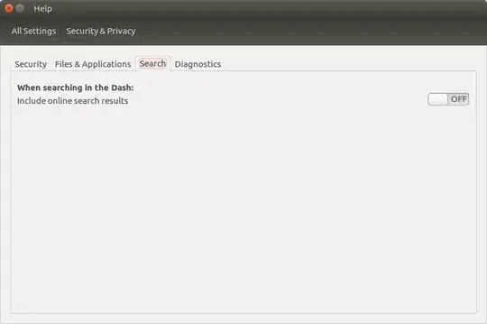

  • Regarding personal data: Canonical still does this though it is now an opt-in instead of opt-out. It still will not make the FSF happy: they consider Amazon to be evil (they support DRM and claim it abuses its employees). Does the deal with Amazon make most of us unhappy? Maybe. Some users did make a switch to another operating system. Will this stay in Ubuntu? Probably. Ubuntu is not making a profit and this will generate a little bit of revenue. Do I personally like the Amazon link? Well no. It is the 1st to disappear from my launcher and all the "send data to" options are turned off. Minor nuisance ... big deal for the FSF.
