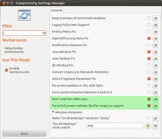

This is a bug with Intel Sandy Bridge graphics.
Unity
A workaround for Unity (or Unity 2D with Compiz) is to enable the options Force full screen redraws (buffer swap) on repaint and maybe also Don't wait for video sync in the Workarounds section of CompizConfig Settings Manager:
GNOME Shell
In GNOME Shell, you can work around the bug by setting the CLUTTER_PAINT environment variable in /etc/environment:
CLUTTER_PAINT=disable-clipped-redraws:disable-culling
CLUTTER_VBLANK=True
