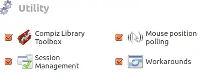

Yes I finally have a solution for you it took a bit of digging, you have to use CompizConfig Settings Manager. Go to Utilty > Workarounds, make sure this box is checked:
Also should be checked:
  • "Don't wait for video sync"
  • "Force full screen redraws"
    screenshot

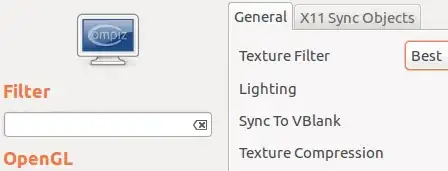

Also some other this you could do is in the CCSM go to "OpenGL" click on the texture tab put Best:
OpenGL screenshot

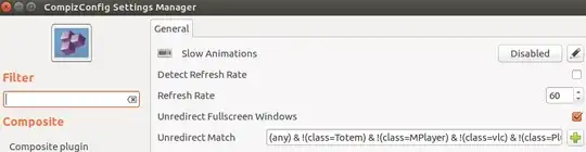

Then go to "Composite" and uncheck "detect rate" then crank up the refresh rate to anything higher than it's default that is set at 50 I set mine to anything beyond 60.
This solved all my problems. Hope this helped. :)
