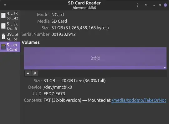

[Problem] You bought an SD card, but you don't know if it's fake or what the real capacity is.
[Solution] Here are the exact steps that worked for me on Ubuntu:
  1. [Terminal] Install f3: sudo apt update && sudo apt install f3
  2. [Disk Utility] Add a drive partition. Format the drive in slow mode as fat. See image.
  3. [Disk Utility] Mount the drive: See image.
  4. [Terminal] write to the disk: sudo f3write /media/toddmo/FakeOrNot
  5. [Terminal] read from the disk: sudo f3read /media/toddmo/FakeOrNot
  6. [Amazon/AliExpress][!important] Leave a review listing the write speed, read speed and true capacity. write read back what you just wrote
(step 3) See image
