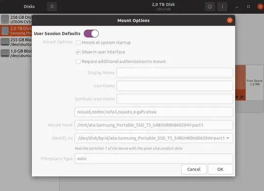

exFat works fine in Ubuntu, even though it's proprietary Windows file format. If your driver can't mount automatically after installing the right package (sudo apt install exfat-fuse exfat-utils)
Go to Disks -> Choose the disk -> Click on the configuration icon (called Additional partition options) -> Edit Mount Options... -> Turn on "User Session Defaults".
mount problems resolved
In my case the problem with mounting appeared after using the SDD on Windows. The mount point "/mnt/sdb1" started to be incorrect somehow.
