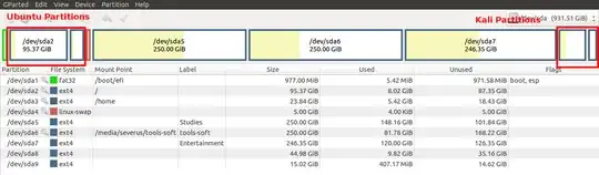

  • My system partitions :
enter image description here *for higher resolution click here

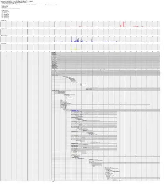

I noticed that there is a gap of 72 Sec between line 971 to 972 in dmesg file.
I don't know why ?
Please help me to solve this problem.

Boot from Ubuntu installation media.
Select Try Ubuntu without installing.
Step 1 : Reinstall the Ubuntu GRUB boot loader.
Open a terminal and execute :
sudo mount /dev/sda2 /mnt
sudo mount /dev/sda1 /mnt/boot/efi
for i in /dev /dev/pts /proc /sys /run; do sudo mount -B $i /mnt$i; done
sudo chroot /mnt
grub-install /dev/sda
update-grub
exit
Step 2 : Correct the UUID entries in the fstab file.
Open another terminal and execute :
sudo blkid
sudo gedit /mnt/etc/fstab
Replace the UUID entries of sda1 | sda2 | sda3 | sda4
with those of the output given from the blkid command.
Close all terminals and reboot into Ubuntu operating system.

Re-install grub and update entire fstab is more then necessary! if you wand the ubuntu splash-screen in grub instead kali splash-screen, yes you can reinstall grub.
kali(debian) installer, when installed belong another distro, do not take care about there have an existing swap partition so the installer format it again; once the swap partition has been formatted the UUID has change!
The only necessary is up to date the UUID of swap partition in the fstab and in "/etc/initramfs-tools/conf.d/resume" and regenerate the initramfs to let hibernation work again.
