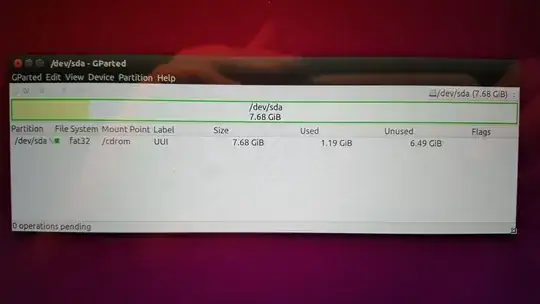

In gparted, the only visible drive is the 8gb usb drive that contains the installation iso, the system drive is not visible.

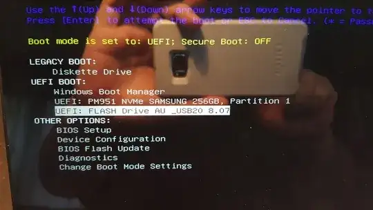

still having issues. I disabled fast startup and hibernate, here is my bios boot selection: (was not connected to network and unable to save screenshot)
bios selections

and here is what shows in gparted (again from the live usb iso): gparted
I found this doc and have been going thru it. I was not able to determine how to disable the intel smart response technology.

I changed the sata config mode to ahci, that allowed me to install ubuntu and boot into it, but I was not able to boot back into windows.
I then downloaded a win10 iso, and did a clean install with the bios set to ahci. (had to download wifi driver)
I then tried to install ubuntu. In gparted, I still only saw the usb drive, but during the ubuntu install I had the option to "install alongside windows boot manager".

  1. Disable secure boot in BIOS.
  2. Also make sure that you are installing Ubuntu in EFI mode as Windows is also installed in EFI mode.
  3. Turn off hibernation and fast boot from Windows
