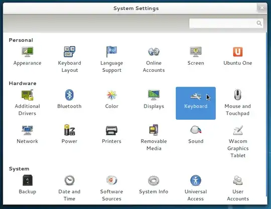

You can set up your shortcuts in the Keyboard section of System Settings. You can either open System Settings in the Activities search or use the upper-right menu.
Then open Keyboard.

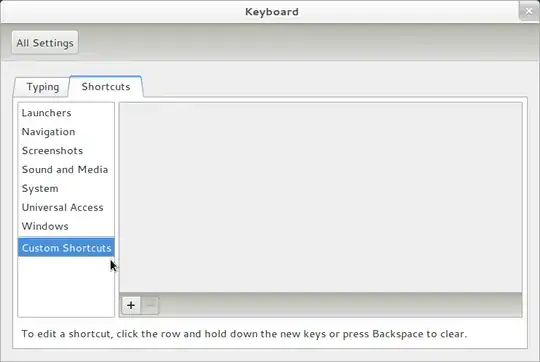

You'll see a section for Custom Shortcuts on the bottom left-hand side, if what you're changing is not already present in a section above.
