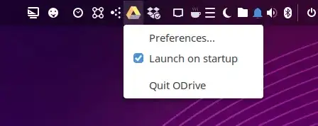

EDIT
Just noticed ODrive which works substantially different. ODrive actually downloads the files and synchronizes with Google Drive, similar to how the Windows version of Google Drive works.
The big advantage -at least to my experience- is the immediate response to editing & saving, while the previously mentioned solutions have a huge delay on the work process during saving.
