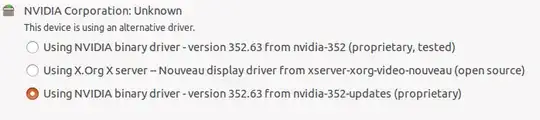

I'm using the proprietary nvidia driver found in the "Additional Drivers" app. But setting that to use the nouveau display driver doesn't help either.
drivers

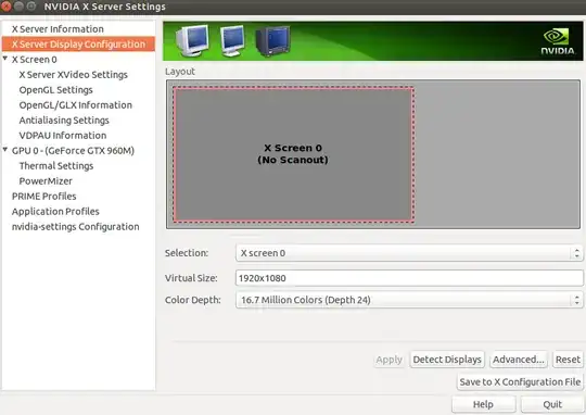

nvidia-settings sees only one screen. nvidia-settings

UPDATE: I've installed 15.10. Installed the "Intel Graphics for Linux" drivers. And it still doesn't work. But now when I click on "Detect Displays" in nvidia-settings, the application segfaults. Don't know if this has any relevance.
