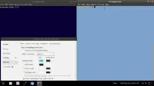

In the below GIF, I have two terminals open. The left one is the profile with ID starting with "dec6" and the commands I gave in other Terminal with different profile..
