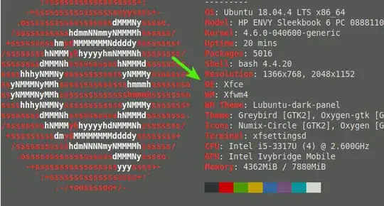

Just two cents.
$ sudo apt install neofetch
$ neofetch
