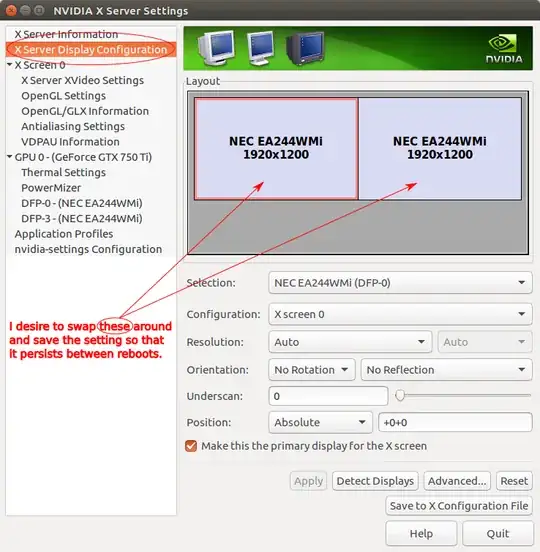

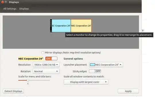

To expound further on one aspect of @Jacob's answer: The monitor.xml file does override any similar left-to-right ordering that is set up in the nVidia Settings. Under Unity, System Settings/Display updates the ~/.config/monitor.xml file. Change the order of what monitor is on the left or right by dragging and dropping the rectangular boxes at the top of the window:
Start nVidia Settings via the main Search Your Computer button:
And it is here that you think you can change the order, but the monitor.xml file will override it:
I was tempted to just delete the monitors.xml file, in hope that the nVidia Settings would take command of the situation, but a comment on another answer implies this is not a good thing to do.
