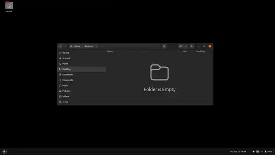

The 'Files' window doesn't show in the taskbar. Any other application will show when started but files does not. I'm running dash to panel on Ubuntu 21.10. Is there a setting I'm missing?
~$ wmctrl -m
Class: N/A
PID: N/A
Window manager's "showing the desktop" mode: OFF
~$ echo $DESKTOP_SESSION $XDG_CURRENT_DESKTOP
ubuntu-xorg ubuntu:GNOME
Files window not showing in taskbar Dash to panel settings

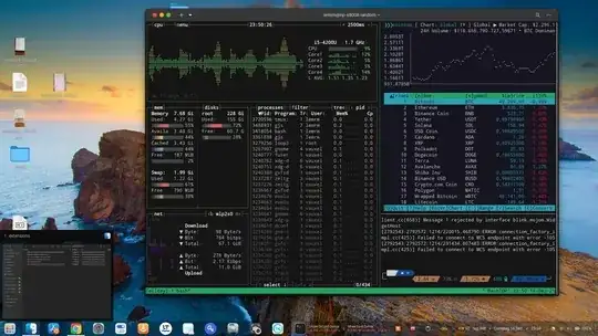

Works for me (21.10). My setup :
sudo apt install ubuntu-desktop-minimal
sudo apt reinstall gdm3 gnome-shell gnome-session
also installed
dpkg -l | grep '^ii' | grep gnome
ii  chrome-gnome-shell
My current environment (from here)
  • Window manager: wmctrl -m
  • Session: echo $DESKTOP_SESSION
  • Desktop environment: echo $XDG_CURRENT_DESKTOP
For me it is i.e. GNOME-Shell, ubuntu-xorg and ubuntu-GNOME gnome-shell --version 40.5
All extensions installed from:
gnome extensions website
Here my installed extensions.
~/.local/share/gnome-shell/extensions$ sudo ls -l
  drwxrwxr-x 3 user user 4096 Dez  1 18:30 apps-menu@gnome-shell-extensions.gcampax.github.com
  drwxrwxr-x 4 user user 4096 Dez  1 18:32 clipboard-indicator@tudmotu.com
  drwxrwxr-x 5 user user 4096 Dez  3 11:18 dash-to-panel@jderose9.github.com
  drwxrwxr-x 3 user user 4096 Dez  1 18:50 panel-date-format@keiii.github.com
  drwxrwxr-x 7 user user 4096 Apr 21  2021 stocks@infinicode.de
  drwxrwxr-x 3 user user 4096 Dez  1 18:30 user-theme@gnome-shell-extensions.gcampax.github.com
