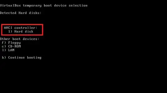

I installed Ubuntu on virtual box and shut down the machine when prompted to restart the computer. However, when I turned it back on it asked to install the program again. When I got to the page where it asks if you want to install Ubuntu on its own or have it run with the current OS it shows the Ubuntu that I had already installed. How do I access the one I installed already? Installation Type Screenshot
Eject disk from your Virtual Machine or restart machine and start press F12 to open boot menu (if EFI enabled, ESC key.), select HDD.
