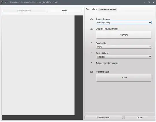

The drivers already mentioned in the question are just fine, only they cannot be used with the Simple San or Xsane tools, but they install a tool called ScanGear that can be launched with the command scangearmp.
Outputs: png, pdf, pnm.
To add a .desktop launcher for that:
sudo gedit /usr/share/applications/scan.desktop
and paste this:
[Desktop Entry]
Categories=Graphics;Scanning;
Exec=scangearmp
Icon=scanner
Name=Scan
Type=Application
The same can be used within Gimp: File/Create/ScanGear MP, but ScanGear does not need Gimp in order to work.
Sources are linked in my other answer.
