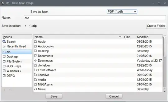

Or run from Gimp: File-Create-SangearMP.
ScanGear can save as pdf
