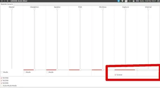

I had the same problem (internal mic not working) with my Lenovo Ideapad 320, which runs Ubuntu 18.04.
I installed GNOME ALSA Mixer from the Ubuntu Softwares Panel and followed another topic instruction: put the "Capture" full on the right and "Internal" empty on the left, as the following image:
see this screenshot
It worked well for me.
