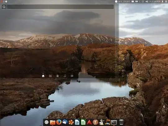

I would like to modify unity to not show the launcher (left side bar) at all. I'm not looking for any solution that would let the launcher be in some cases visible. I really want it to completly disappear. It's a gift for my fiance and I want to achieve the highest possible Woman Acceptance Factor for her linux laptop which is running a docky dock with fancy icons that make it look like being from that known and fruity company.
Any hints about which packages and which source files I should study?
I'm hoping it to be as easy as commenting out the line with "unity.launcher.show()" and recompiling :-)
Thank you!

The answer to my own question is:
  • Launcher.cpp, unityshell.cpp, DashController.cpp and HudController.cpp for unity version < 7.4.0 and
  • Launcher.cpp and UnitySettings.ccp for unity version 7.4.0
from the unity source package.
But I'm answering more than that since everybody looking for the answer to my question will also be interested in knowing what to do with those source files.

That's it. Restarted unity and the launcher went away!
