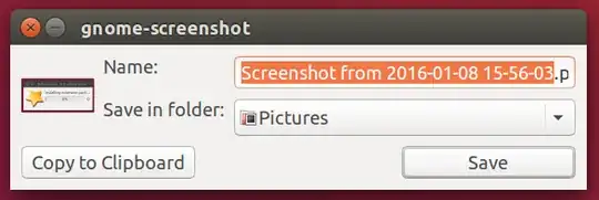

Since I switched to a High DPI display, the screenshots I post are awkwardly big, example below.
Is there a way to quickly make them look normal?
Preferably something faster than firing up GIMP.
In particular, is there a hidden option for this in gnome-screenshot?
  • There is probably no perfect tool, since the way to adapt Ubuntu to High DPI is not uniform (fonts, window decorations, programs, might have different scales), but a good tool would read these settings and figure out what's the best scale to use.
  • Preferably I would like to keep the ability of selecting only part of the screen (as in SHIFT+PRTSCR), and choosing the name of the file.
  • In case that matters, I always save my screenshots in $HOME/Pictures.
