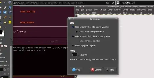

Why not just take the screenshot with Gimp? File > Create > Screenshot.
This requires no intermediate storage at all.

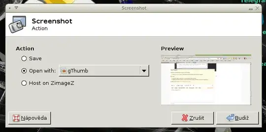

With xfce4-screenshooter you can choose from programs to open screenshot with, or save it. Supports selecting area, delay before taking screenshot. Directly point-and-click solution.
xfce4-screenshooter screen

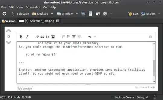

If you're willing to switch screenshot applications, this is an option that scrot provides:
   -e, --exec APP
        Exec APP on the saved image.
EXAMPLE
       scrot '%Y-%m-%d_$wx$h.png' -e 'mv $f ~/shots/'
       and move it to your shots directory.
So, you could change the PrntScr shortcut to run:
scrot -e 'gimp $f'

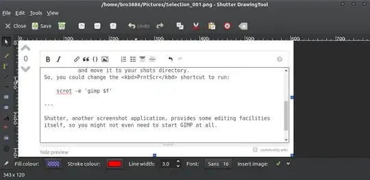

Shutter, another screenshot application, provides some editing facilities itself, so you might not even need to start GIMP at all.

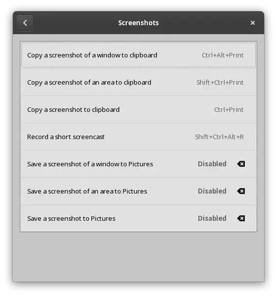

If you're running Gnome then you can use the built-in screenshot shortcuts to at least bypass the "save to disk and open the file" step.
  1. Press the appropriate "to clipboard" shortcut (basically the standard "save to file" shortcut with Ctrl):
    • Ctrl+PrintScreen
    • Ctrl+Alt+PrintScreen to capture a window
    • Ctrl+Shift+PrintScreen to capture an area
  2. Open GIMP
  3. If there are no images open in GIMP, Ctrl+V pastes as a new image
The shortcuts are configurable in Gnome Settings under Keyboard > View and customise shortcuts > Screenshots.
Screenshot of Gnome Settings for screenshotting
I've disabled saving screenshots because I use custom shortcuts with gnome-screenshot to save to ~/temp/ rather than ~/Pictures/ (because I care about Pictures but not about anything in temp, like random screenshots)
