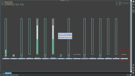

I've got a Dell laptop and had the same problem and was able to resolve it quite easily.
Run alsamixer and terminal , switch to your internal audio card (F6 -> HDA Intel PCH) and disable the "Loopback Mixing option" (select this channel using LEFT\RIGHT keys and switch it of pressing DOWN key
It is clearly noticeable that the noise is gone away once this option is disabled.
