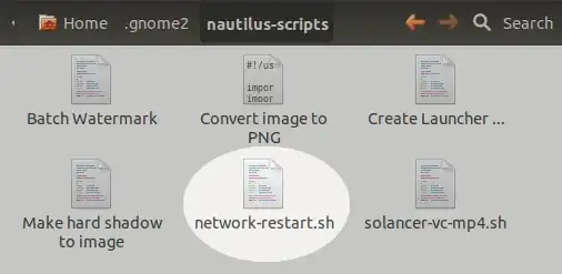

No its not weird at all, I too experience connectivity issues a lot when I use my usb net-setter modem.
Here's how you do it
gksu service network-manager restart
save it in a file with .sh extension and grant executable file permission by right clicking>>properties>>permissions
nmcli is a command-line tool for controlling NetworkManager and getting its status.
