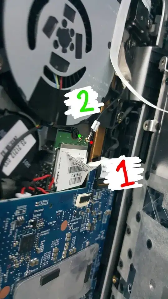

HP has started to use only one antenna on some of their laptops as found in this post by Jerry Gorland who has a Stream 11 and a picture from here by modev32 modev32 picture from lwfinger github
Larry Finger stated that Realtek is working on code that will detect what connector the antenna is connected to but no timeline has been released
