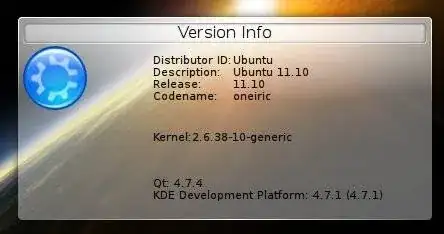

Rebooting
Picking from the grub > Previous Linux versions > Kernel 2.6.38-10
...and the (K)Ubuntu is telling that i'm running with the 2.6.38-10-generic /2/.
