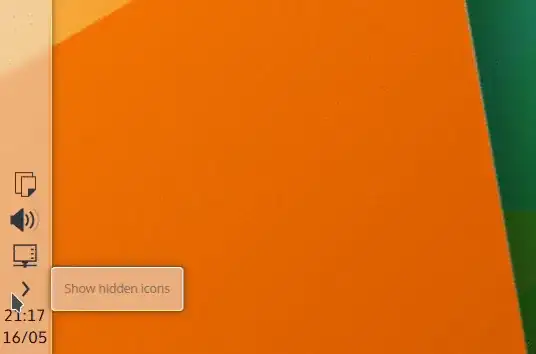

At here
After I insert a CD I have to click the 'Show hidden icons' to get the Device Notifier.
Another hickup is: How can I get the Plasma 5 Device Notifier to give me appropriate options for DVDs after upgrading from Kubuntu 14.10 to 15.04?
