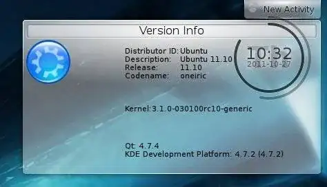

A bit earlier there was a question: How to downgrade the Kernel on 11.10. Upgrading the kernel is not harder.
You could download the kernel binaries from the old or new Ubuntu releases1. The Precise2 has the 3.1. Also the Kernel Mainline build3 has the 3.1.
Donwloading from the Mainline the linux-image-3.1.0-030100rc10-generic. Installing it. Rebooting with it and the (K)ubuntu 11.10 is running with the 3.1.
Screenshot showing kernel 3.1 running under Kubuntu
