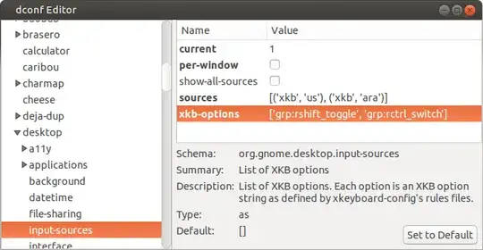

So for Gnome:
  1. Use dconf-editor → org → gnome → desktop → input-sources
  2. Add setxkbmap options to xkb-options, example:
    ['grp:rctrl_switch']
To see all possible options:
more /usr/share/X11/xkb/rules/xorg.lst | grep grp:

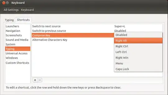

Please follow these steps:
  1. Select System Settings... from system menu; snap1
  2. Select Keyboard; snap2
  3. Under the tab labelled Typing click Layout Settings; snap3
  4. In the Keyboard settings window, under Shortcuts tab, select Typing. The default for Switch to next source is Super+SPACE; clicking on it will ask you to assign a New Accelerator..., press the desired key combination to change to next Layout (I used Super+L.) and it will be assigned to change to next layout.
    (Then I assigned something similar for Switch to previous source using the same preferred layout, and then began to test them. Switching from the preferred layout to the alternate worked but the reverse did not. Please refer the next step for the fix.) saucy1
  5. In the same window you can select/assign Compose key. The preferred one is Right Alt composeKey
  6. After assigning Super+L for "Switch to next source" using my preferred layout, I changed my keyboard layout to the alternative layout and then assigned the combination to "Switch to previous source" (for which I used Shift+Super+L). Then I tested them, and they work fine.
    The new accelerators for the key combos that I used looks like this: saucy2
