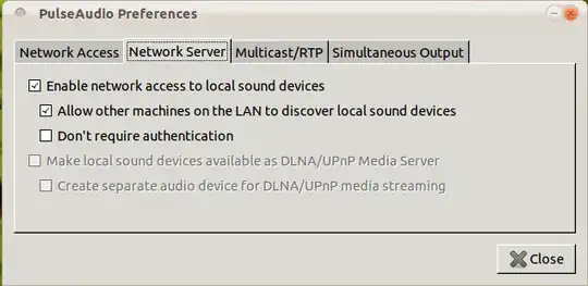

I found this question which indicated I should use something called "paprefs" to acheive this. So, I installed paprefs and then in the "Network Server" dialog, I selected these settings:
paprefs
And then... I have no idea what is supposed to happen. I checked the paprefs home page, and all they say under Documentation is "There is not much to say. Just run paprefs and see for yourself."
I don't see anything happening or any way I'm supposed to make the connection from Computer A to Computer B.

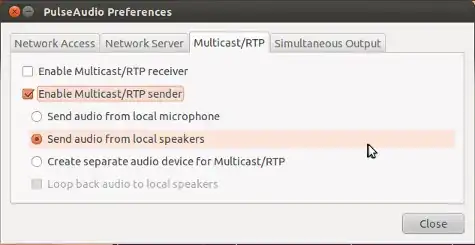

On the sender:
paprefs screenshot showing "enable multicast/rtp sender" checked and "send audio from local speakers" selected
Choose your local soundcard or choose a separate device you can select as audio output from Audio Preferences.

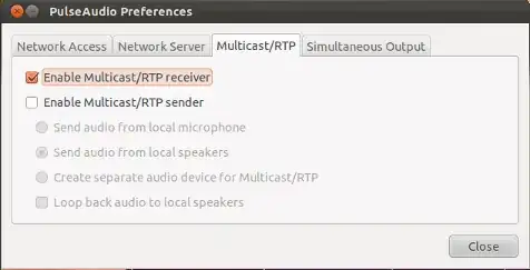

On the receiver:
paprefs screenshot showing "enable multicast/rtp receiver" checked
By doing so audio will be sent from the sender to the receiver via your LAN.
