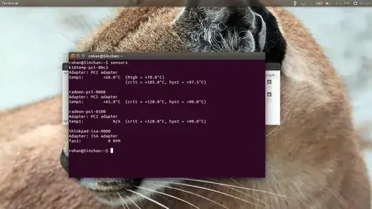

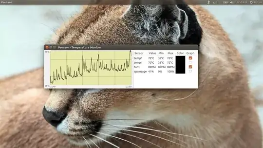

I installed psensor and found out that temperature of my laptop was around 75 Celsius.Sometimes it become 80 also.I also found out my fan was not running.

Most likely your system has a bad ACPI bios that uses goofy non standard fan control mechanisms that require proprietary windows drivers and do not work in linux. Your only hope is to install the lm-sensors package and see if sensors-detect can find hardware that fancontrol knows how to take over.
