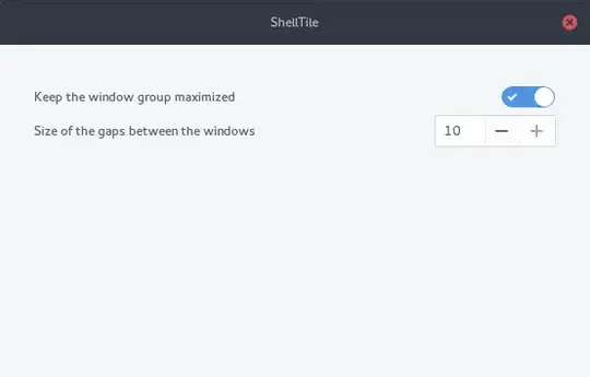

Gnome Shell can be changed using Gnome Extensions - I think this extension will work for you:
This is done by dragging and dropping the windows into position, it will show a orange highlight (doesn't seem to match the theme :/ ). You can change the gap between windows in the settings:
Though currently this extension is not available for GNOME 3.18, so you will have to give this workaround a go.

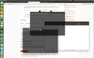

On the edge of posting a duplicate of this one (but the question slightly differs), the script below does what you describe, if you run it with the arguments
python3 /path/to/script.py 2 2
However, if there are more than four windows (or more than the cells of a grid, if you use other arguments than 2 2), the script places only the four oldest windows in the grid.
What it does
When four windows are opened, randomly placed on the screen:

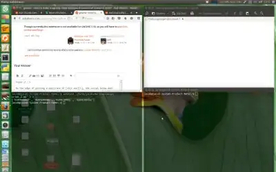

running the script will arrange them in a grid:

    The windows should move into a grid of 4, as in the second image
