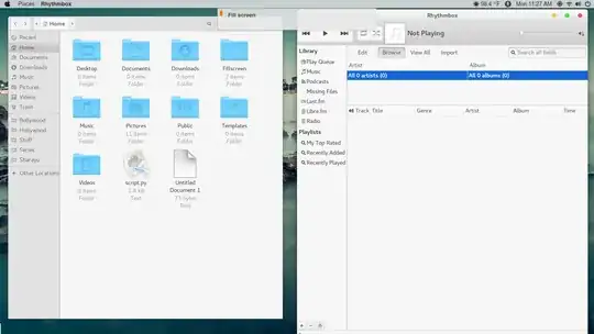

result of the fillscreen.py script
1st result
in first try fillscreen notification came (I couldn't capture that) and it moved the 2nd window (window in the right) in a box, and 1st window wasn't affected at all.

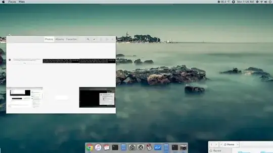

2nd result
in second try, this offset was present, but it did work (and it mostly works)

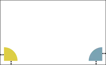

  • The script acts on dragging one of the two "newest" windows to one of the two areas on the screen, as shown in the image.
    The area is deliberately not tight into the corner, to make sure it does not interfere with "normal"window snapping.

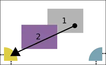

  • If the window is dragged on to either one of the areas, the script waits 0.15 second to see if the mouse is still in the same position, to make sure not to act if the user was "on his way" to the corner of the screen for normal window snapping.

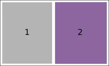

  • Subsequently, the dragged window is snapped into the half of the screen the area is on, the second window is snapped to the opposite side of the screen
    1. drag the window to the area
    2. the window snaps, the other one snaps to the opposite site
