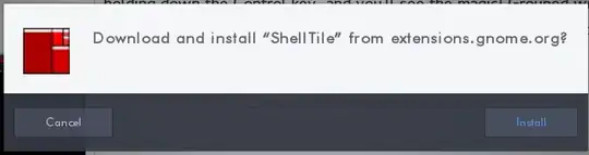

I am trying to install this GNOME Shell extension as shown in this answer, however even though I press the switch to make it On rather than Off and I click Install on the little dialog that I get, when I refresh the page it is Off again and there is no sign of it in gnome-tweak-tool.
I have tried installing other extensions the same way and there is no problem, so why am I unable to install this one? I am running Ubuntu GNOME 15.10 with GNOME 3.18.

  • If you have not previously installed the extension it should show something like: enter image description here If it is installed and working you there will be a preferences icon
