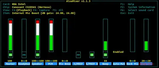

  2. I checked alsamixer but could not find anything unusual. Here a screenshot where the internal microphone is selected (last column, red).
    alsamixer screenshot

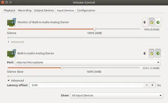

  3. I checked puvacontrol. Nothing suspicious there.
    puvacontrol
