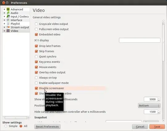

  1. Open VLC Media player and go to Tools -> Preferences (Shortcut key is CtrlP)
  2. Select All from Show settings in the bottom-left corner of the Preferences window .
  3. Now click the Video Tab on the side.
  4. Now tick the Disable Screensaver box and click save.
