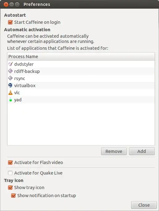

As an intermediate work-around, try installing Caffeine. Enter the following commands in a terminal.
sudo add-apt-repository ppa:caffeine-developers/ppa
sudo apt-get update
sudo apt-get install caffeine
Then…
  1. Run Caffeine from the Dash, which displays a small icon on the right side in your top panel. Caffeine and its menu in the top panel
  2. Click it once to display the Preferences. Caffeine preferences
  3. Check Start Caffeine on login.
  4. Use the Add button to add vlc (in lowercase).
